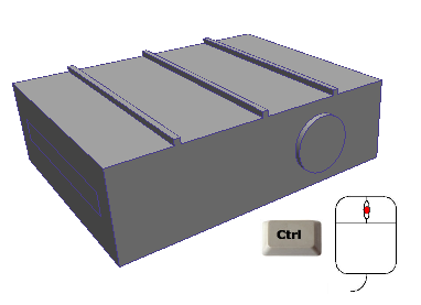

2. Make sure all parts are visible by holding Ctrl and middle clicking anywhere off the model.
3. Left click on the inlet surface.

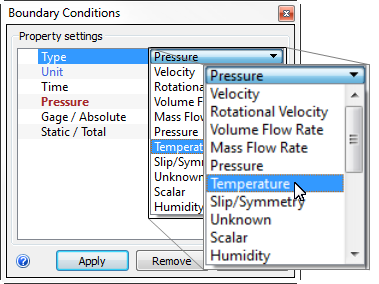

4. Click Edit from the Boundary Conditions context panel:

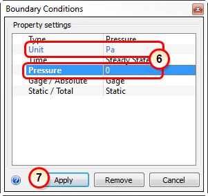

5. On the Type row, select Pressure.
6. Set the Unit to Pa and the Pressure value to 0.
7. Click Apply.

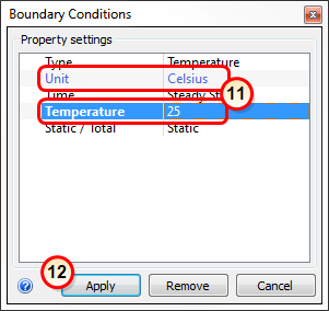

10. On the Type row, select Temperature.
11. Verify the Units are Celsius. On the Temperature row, enter 25.
12. Click Apply.
