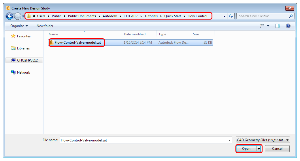

On the New Design Study dialog, click Browse
Navigate to C:\Users\Public\Public Documents\Autodesk\CFD 2023\Tutorials\Quick Start\Flow Control, and select Flow-Control-Valve-model.sat. Click Open.

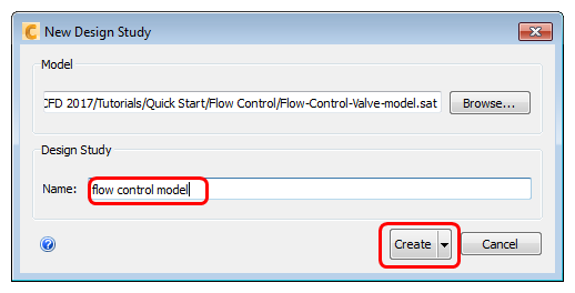

On the New Design Study dialog, enter a name for the Name, make sure the active option on the button is Create, and click Create:

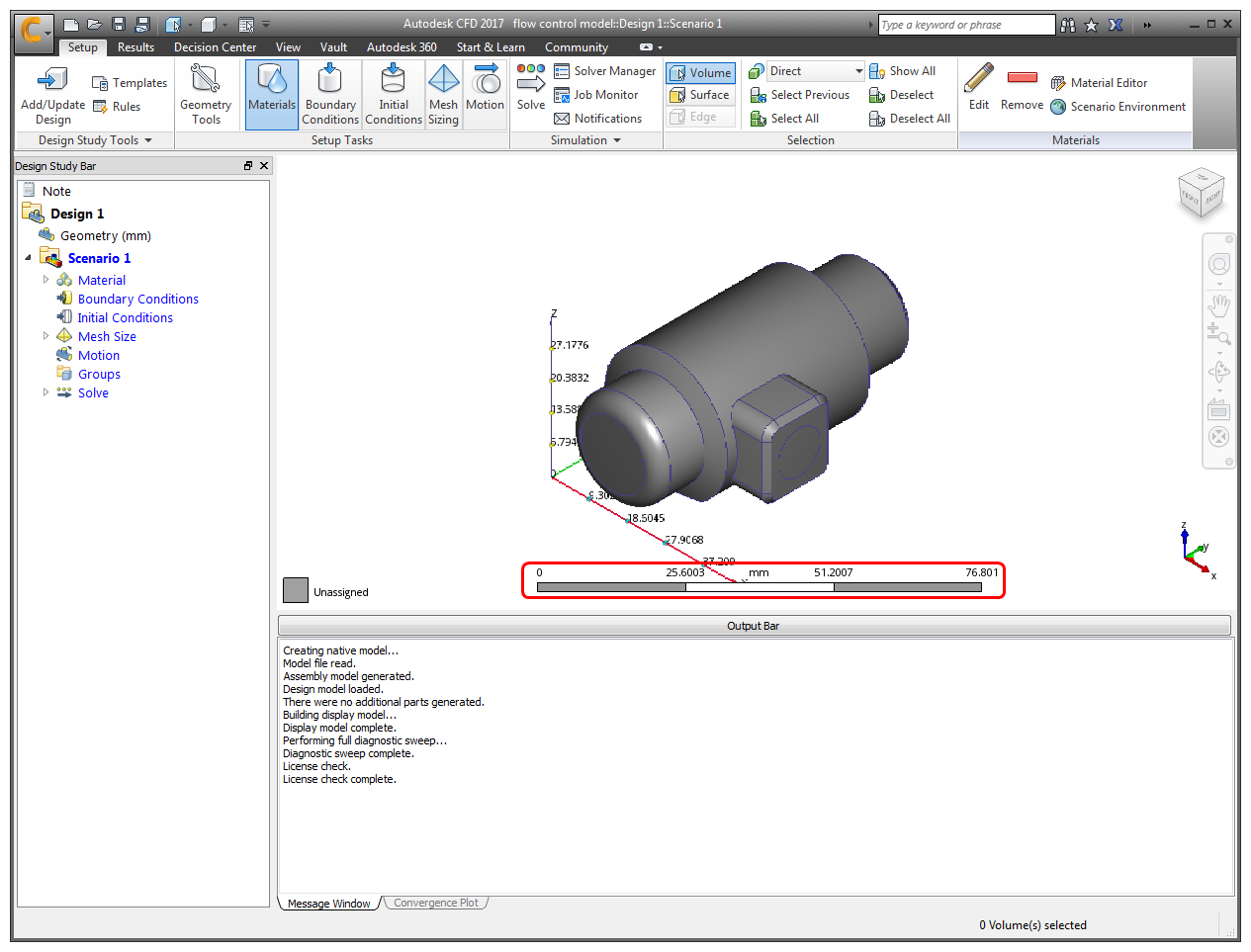

The geometry imports in units of meters, we need to convert it to mm. To do this:
What it should look like:
Autodesk® CFD should start, and you should see the model. Note the dimension values on the scale:
