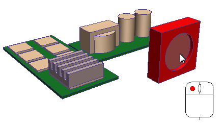

In this step, we assign a fan material to blow cooling air through the system.
1. To start, select the fan by left clicking on it:

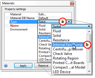

2. Click Edit from the Materials context panel.

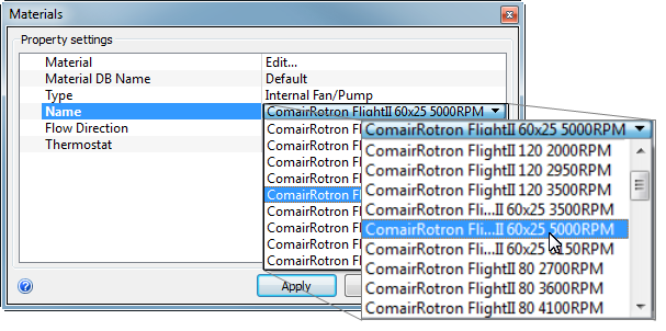

3. On the Materials quick edit dialog, select the material type:

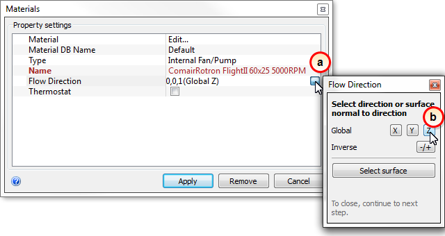

4. From the Name menu, select ComairRotron FlightII 60x25 5000 RPM.
5. To set the flow direction at the fan discharge:

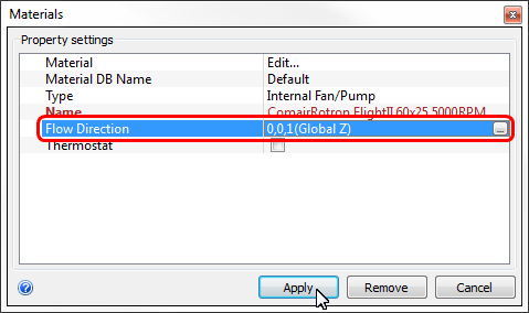

6. Verify that the flow direction is 0, 0, 1, and click Apply.
What it should look like...

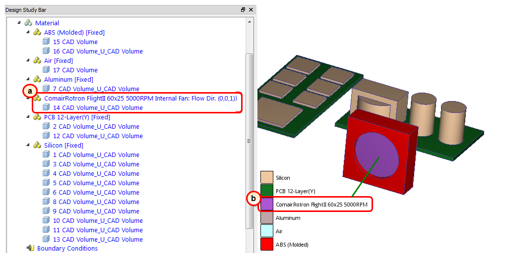

7. To verify that the fan material is properly assigned, check the Design Study Bar and the part coloring:
This is a good time to check the material assignments in the Design Study Bar.
