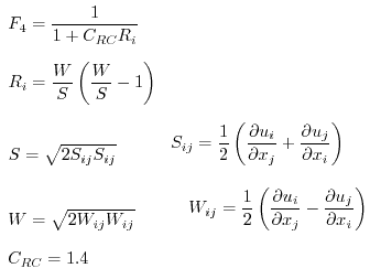

In the Hellsten simplified Rotation/Curvature form of the SST model, the destruction term is multiplied by the following function:
where:
