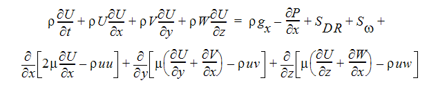

X-Momentum Equation

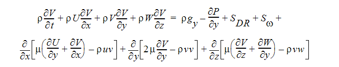

Y-Momentum Equation

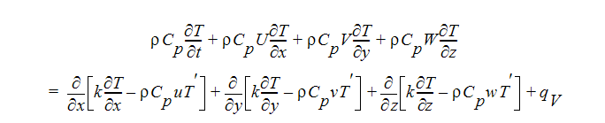

Energy Equation

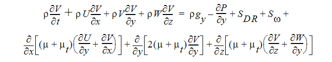

Y-Momentum Equation
