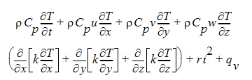

For the case where Ohmic or Joule heating is to be considered, the following energy equation applies for incompressible flow:
where i is the magnitude of the current density and r is the electical resistivity, a material property. With this equation, an equation to determine the electric current in the Ohmic term ri2 must also be solved. We use the electric potential equation:
where is the electric potential and the current is found using:
The variables used in these equations are defined in the table below:
