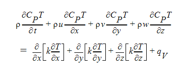

As noted earlier, the energy equation for moist gas flows is written in terms of temperature with a variable specific heat:
