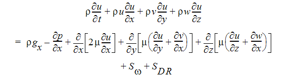

X-Momentum Equation:

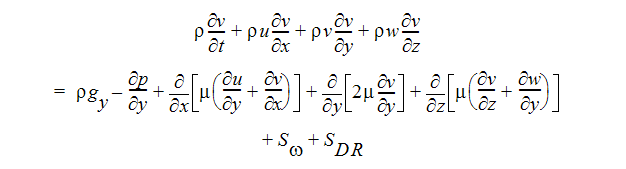

Y-Momentum Equation:

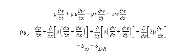

Z-Momentum Equation:

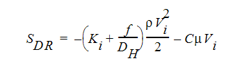

The two source terms in the momentum equations are for rotating coordinates and distributed resistances respectively. The distributed resistance term can be written in general as:
where i refers to the global coordinate direction (u, v, w momentum equation) and the other terms are described in the previous section. Note that the K-factor term can operate on a single momentum equation at a time because each direction has its own unique K-factor. The other two resistance types operate equally on each momentum equation.

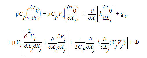

For compressible flow, the energy equation is written in terms of total temperature:
where
is the dissipation function. Note that Einstein tensor notation is used for the total energy equation for conciseness. The last three terms are only present for compressible flows.

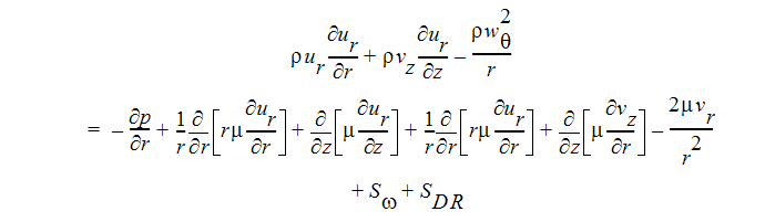

R-Momentum Equation:

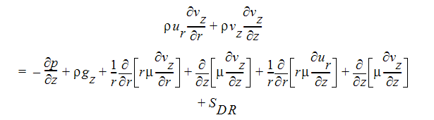

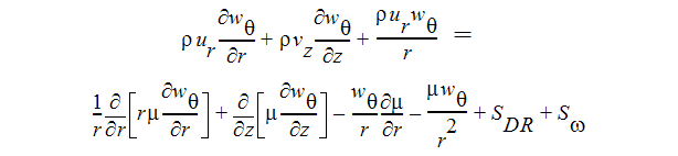

Swirl-Velocity Equation:
