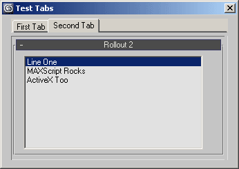

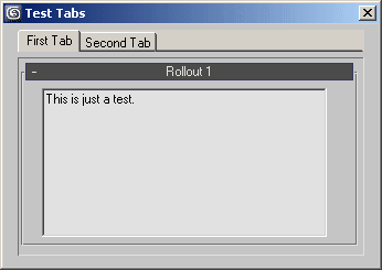

   rollout firstRollout "Rollout 1" (
   edittext edittext01 text:"This is just a test." height:135 width:262 )
   rollout secondRollout "Rollout 2" (
   listbox listbox02 items:#("Line One","MAXScript Rocks","ActiveX Too") width:260 )
   rollout testTabs "Test Tabs" (
   activeXcontrol ax_tabs "MSComctlLib.TabStrip.2" height:20
   subRollout theSubRollout height:180
   on ax_tabs Click do
   case ax_tabs.SelectedItem.index of
   1: (
   removeSubRollout theSubRollout secondRollout
   addSubRollout theSubRollout firstRollout
   2: (
   removeSubRollout theSubRollout firstRollout
   addSubRollout theSubRollout secondRollout
   on testTabs open do
   ax_tabs.tabs[1].caption = "First Tab"
   ax_tabs.tabs.add pvCaption:"Second Tab"
   )--end rollout
   createDialog testTabs 340 220
   addSubRollout testTabs.theSubRollout firstRollout
