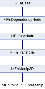

C++ API Reference
PointOnCurveManip function set. More...
#include <MFnPointOnCurveManip.h>
The PointOnCurveManip allows the user to manipulate a point constrained to move along a curve, in order to specify the "u" curve parameter value. This manipulator generates a single floating point value corresponding to the curve parameter.
