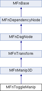

C++ API Reference
ToggleManip function set. More...
#include <MFnToggleManip.h>
Public Member Functions | |
