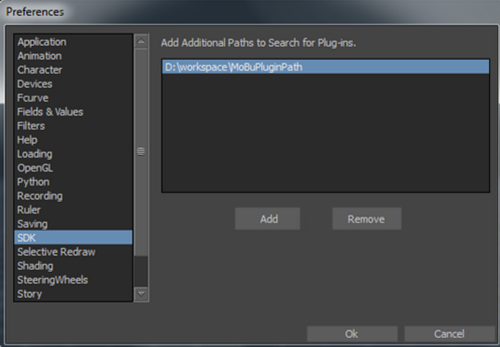

    After the project is built successfully, the resulting library is saved in /bin/x64/plugins. Make sure that you have write access to this folder, or configure the build environment and specify the destination folder as one of the additional plug-in directories. You can add additional plug-in paths either by setting the MOTIONBUILDER_PLUGIN_PATH environment variable or by using the Preferences dialog as shown in the following figure.
    The plug-ins that are saved in these specified folders are automatically loaded at startup.
