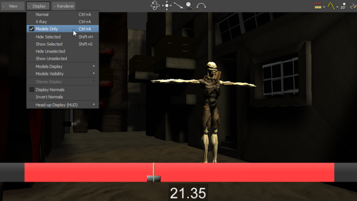

The following figure shows the Models-Only display mode.

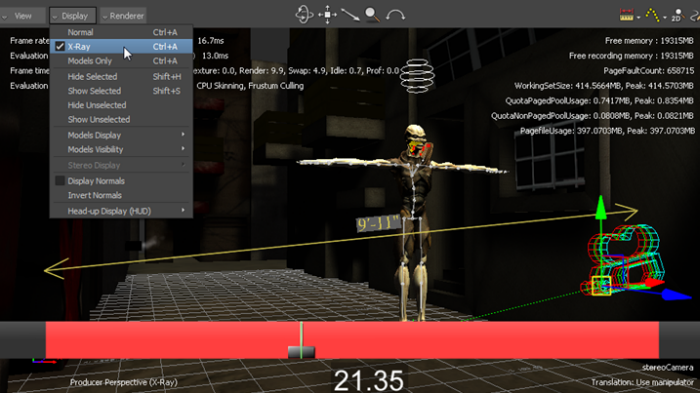

The following figure shows how the X-ray and Normal display mode draw extra elements in the viewport.
