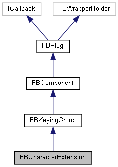

Inheritance diagram for FBCharacterExtension:
