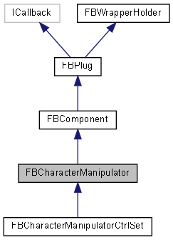

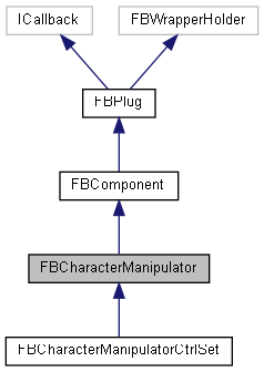

Character Manipulator class.
Definition at line 165 of file fbcharactermanipulator.h.
