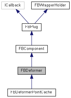

Base Model deformer class.
Definition at line 1485 of file fbmodel.h.
