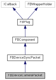

Camera device packet. More...
#include <fbtracker.h>
Public Member Functions | |
| FBDeviceCameraPacket () | |
| Constructor. More... | |
Public Member Functions inherited from FBDeviceSyncPacket | |
| FBDeviceSyncPacket () | |
Contains information necessary to position a virtual camera in 3D space.
Definition at line 199 of file fbtracker.h.
