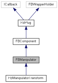

Manipulator class. More...
#include <fbmanipulator.h>
