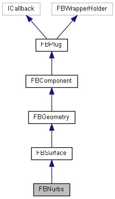

| | FBNurbs (const char *pName, HIObject pObject=NULL) |
| | Constructor. More...
| virtual void | SurfaceBegin () override |
| | Begin NURBS definition. More...
| virtual void | SurfaceEnd () override |
| | End NURBS definition. More...
| virtual void | SurfaceEditBegin () override |
| | Begin NURBS surface edition. More...
| virtual void | SurfaceEditEnd () override |
| | End NURBS surface edition. More...
| virtual void | ControlPointsBegin () override |
| | Begin NURBS control points edition. More...
| virtual void | ControlPointsEnd () override |
| | End NURBS control points edition. More...

| | FBSurface (const char *pName, HIObject pObject=NULL) |
| virtual void | SurfaceBegin () |
| virtual void | SurfaceEnd () |
| virtual void | SurfaceEditBegin () |
| virtual void | SurfaceEditEnd () |
virtual bool | GetSurfaceCapped (int pUorV, int pDirection) |
virtual int | GetVertexCount (int pUorVorGlobal=-1) |
| virtual void | ControlPointsBegin ()=0 |
virtual void | SetControlPoint (int pIndex, double pX, double pY, double pZ, double pW) |
virtual void | GetControlPoint (int pIndex, double &pX, double &pY, double &pZ, double &pW) |
| virtual void | ControlPointsEnd () |
