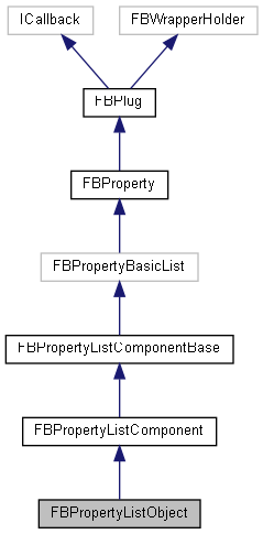

Inheritance diagram for FBPropertyListObject:
