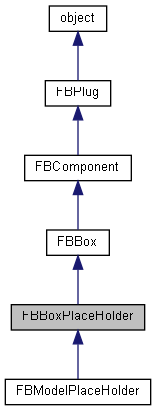

Inheritance diagram for FBBoxPlaceHolder:
