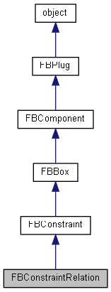

ConstraintRelation class.
This class exposes the relation constraint and allows addition of new boxes and removal of existing ones.
See samples: CreateAndPopulateAConstraintRelation.py, TraversingRelationConstraint.py.
