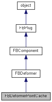

Inheritance diagram for FBDeformerPointCache:
