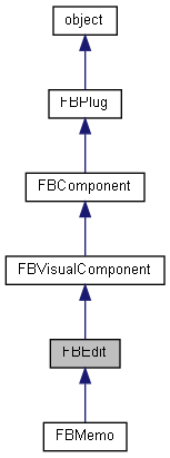

Text edit box. More...
#include <pyfbsdk_generated.h>

Text edit box.
FBEdit | ( | ) |
Constructor.
