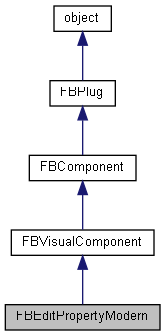

Property editor widget.
This is a more modern version of the widget FBEditProperty which is used in the property editor tool of the application.See class FBEditProperty for more details.
