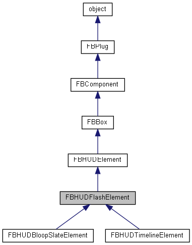

Inheritance diagram for FBHUDFlashElement:
