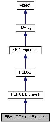

Inheritance diagram for FBHUDTextureElement:
