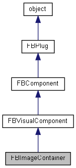

Image. More...
#include <pyfbsdk_generated.h>
Public Member Functions | |
| FBImageContainer () | |
| Constructor. More... | |

| FBImageContainer | ( | ) |
Constructor.
| str Filename |
Read Write Property: Filename for image.
| FBEvent OnDragAndDrop |
Event: Drag and drop.
| bool UseTransparentBackground |
Read Write Property: True to specify that the image is using a transparent background, false otherwise.
