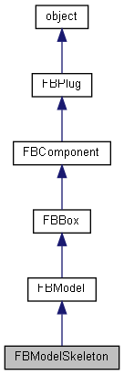

Root object class. More...
#include <pyfbsdk_generated.h>

Root object class.
| FBModelSkeleton | ( | str | pName | ) |
Constructor.
| pName | Name of skeleton. |
| GetSkinModelList | ( | FBModelList | pSkinModelList | ) |
Return the list of skin model associated with this Skeleton(Bone), which could be the deformable skins connected via cluster, or non deformable skins which are parented directly under this bone.
| pSkinModelList | List to be appended with skin models (with no duplicated items). |
