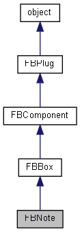

Note class. More...
#include <pyfbsdk_generated.h>
Public Member Functions | |
| FBNote (str pName) | |
| Constructor. More... | |
| bool | Attach (FBComponent pComp=None) |
| Attach the note to a component. More... | |
| bool | Detach (FBComponent pComp=None) |
| Detach the note from a component. More... | |

Note class.
| bool Attach | ( | FBComponent | pComp = None | ) |
Will attach the note to the component. If pComp is NULL, the note will only be added to the scene.
| pComp | Component on which to attach note. |
| bool Detach | ( | FBComponent | pComp = None | ) |
Will detach the note from the component. If pComp is NULL, the note will be removed from the scene and detached from all components.
| pComp | Component from which to detach note. |
| str StaticComment |
Read Write Property: Comment associated to this note.
