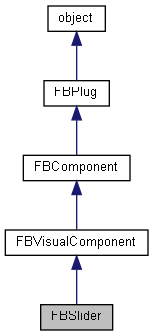

Slider. More...

| FBSlider | ( | ) |
Constructor.
