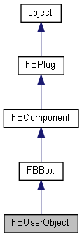

#include <pyfbsdk_generated.h>
Public Member Functions | |
FBUserObject (str pName) | |
Constructor. More... | |
