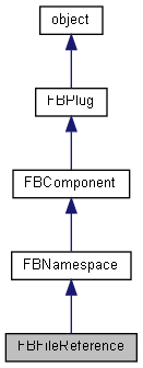

Objects Containing class. More...
#include <pyfbsdk.h>
This class is an interface to manipulate object's containing in the scene.
