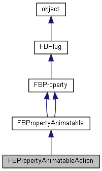

Inheritance diagram for FBPropertyAnimatableAction:
