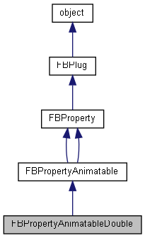

Inheritance diagram for FBPropertyAnimatableDouble:
