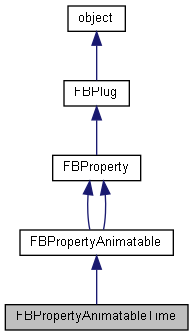

Inheritance diagram for FBPropertyAnimatableTime:
