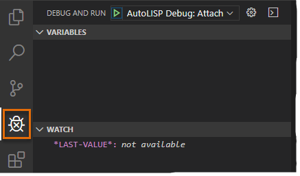

- On the Activity Bar, click Debug and Run (or click View menu > Debug).

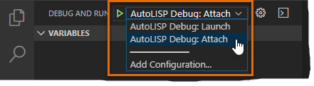

- Click the Configurations drop-down list and choose one of the following configurations:
	 - AutoLISP Debug: Launch – Launches a new instance of AutoCAD and attaches VS Code to that instance
- AutoLISP Debug: Attach – Allows you to attach VS Code to an instance of AutoCAD that is already running

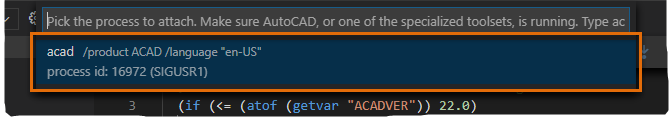

- If you choose AutoLISP Debug: Attach from the Configurations list, choose acad (or AutoCAD on Mac OS) from the list of running processes.

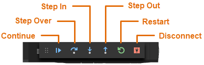

The Debug toolbar contains these tools:
- Continue – Continues the execution of the AutoLISP program to the next breakpoint
- Step Over – An entire expression (and all nested expressions) are evaluated, then execution stops at the end of the overall expression
- Step In – Execution begins and halts before evaluation of the inner parenthetical expression
- Step Out – Execution resumes executing the rest of the expressions within a function and then execution halts on the outermost parenthetical expression
- Restart – Terminates and restarts the debugging operation; the AutoLISP source (LSP) file in the active window is automatically reloaded into the AutoCAD application
- Disconnect/Stop – Terminates the debugging operation and disconnects VS Code from the AutoCAD application
