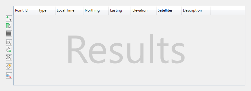

Processed Data Results
This section of the Post Process Kinematic Survey dialog box contains the Civil 3D coordinate geometry points information when the raw RINEX data has been processed.
Processed results are displayed in a data grid and can be previewed in the Civil 3D drawing area; however, points are not created as COGO data in the drawing until you manually insert them.
Note: Columns may be hidden on the Data Grid tab of the Options dialog box.

Tip: You can sort columns alphabetically/numerically by clicking on the headings of each row. Right-click a heading to filter by specific data.
Along the left side of this section are eight tools for previewing the results and manually adding and removing points.
Tip: You can right-click in the Processed Data Results section and select these tools from the context menu.
Points can be manually selected in the results grid to highlight them in the drawing area:
