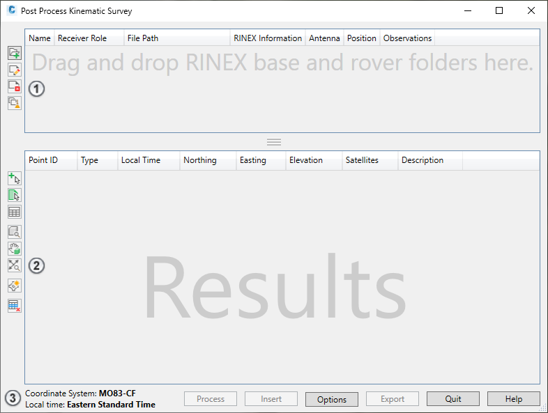

The following image shows the main elements of the Post Process Kinematic user interface.
  1. Raw RINEX Data File Information. Add, edit, and remove files from the current RINEX data to be processed.
  2. Processed Data Results. Filter and locate processed data points in your drawing.
  3. Post Process Kinematic Tools. View the current coordinate system and access tools for processing data, inserting processed data into the drawing, exporting processed data, and other options.
