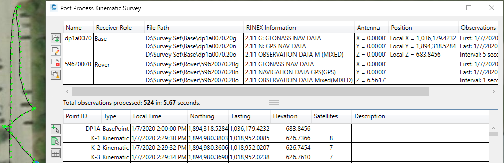

The Autodesk® PPK Survey for Civil 3D® 2024 tool provides an interface for importing base and rover survey data and converting it to coordinate geometry points in a Civil 3D drawing.
Base and rover data are collected by either ground or drone surveying and compiled as Global Navigation Satellite System (GNSS) logs. Post Process Kinematic is a survey data processing technique that allows for multiple iterations with varying settings, to achieve accurate track positioning.
Autodesk PPK Survey for Civil 3D imports base and rover data as Receiver Independent Exchange Format (RINEX) files, processes them to your specifications, and applies them to your Civil 3D drawing as coordinate geometry points. Post Process Kinematic settings can be altered, reprocessed, and reapplied as often as needed to accommodate your drawing.
