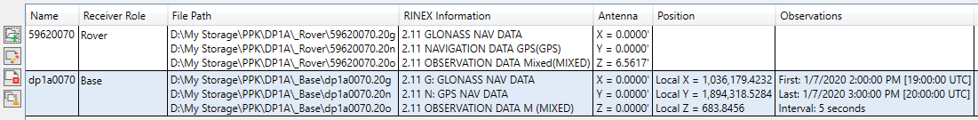

  1. In the Raw RINEX Data Files Information section, click Add Files .
  2. In the Open dialog box, browse to the RINEX files.
  3. Do one of the following:
    • Manually select files and click Open.
    • Drag and drop folders that contain RINEX files onto the Raw RINEX Data Files Information field and click Cancel to close the dialog box.
The Raw RINEX Data Files Information grid displays the imported file information.
