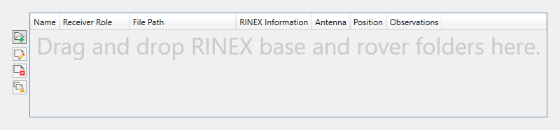

Raw RINEX Data File Information
This section of the Post Process Kinematic Survey dialog box allows for adding and removing the raw data to be processed and visualized.
Once the data is imported, it is displayed in the main data grid to the right. The columns of information are defined as follows:
Name. Specifies the unique name of the receiver.
Receiver Role. Specifies the role of the receiver, either Base, Autonomous, or Rover.
File Path. Shows the file path for each of the data files associated with the receiver.
RINEX Information. Specifies the RINEX navigation and observation data version and type of the receiver files.
Antenna. Specifies the relative coordinate position (XYZ) of the receiver.
Position. Specifies the absolute position of the receiver. Rovers will not report a position.
Observations. Specifies the first and last (start and finish) time stamps and interval scale of the survey for each of the receivers.
Along the left side of this section are four file management tools.
Tip: You can right-click in the Raw RINEX Data File Information section and select these tools from the context menu.
