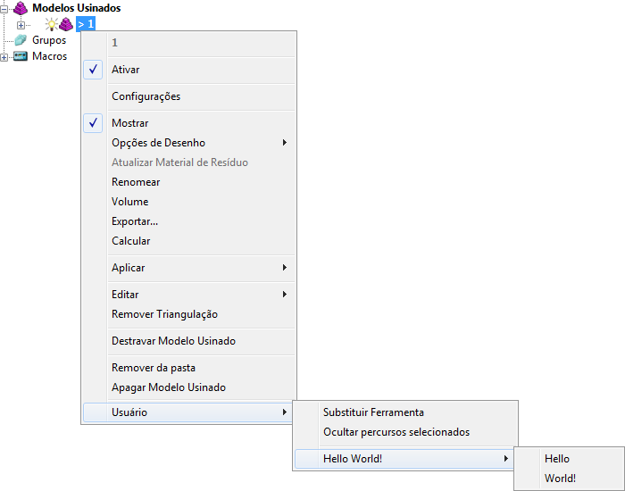

Por exemplo, para criar este menu Usuário e submenu "Hello World!" com espaços relevantes:
O código no arquivo stockmodel.xml é:
<?xml version="1.0" ?>
	<menupage>
		<button label="Replace Tool"
		command='EDIT TOOLPATH "%s" REPLACE_TOOL ;'
		multiple_selection="allowed"/>
		<button label="Undraw selected toolpaths"
		command='MACRO d:/temp/test.mac "%s"'
	<spacer/>
	<menupage label="Hello World!">
		<button command='PRINT "HELLO"' label="Hello"/>
		<button command='PRINT "WORLD"' label="World"/>
	</menupage>
</menupage>
