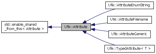

Abstract base class for Attribute interface.
This base class defines an interface for factory objects that runtimes implement to handle the various supported attribute types (such as bool, int, float, etc).
Definition at line 37 of file attribute.h.

Implemented in Ufe::AttributeGeneric, Ufe::AttributeFilename, Ufe::AttributeEnumString, and Ufe::TypedAttribute< T >.
