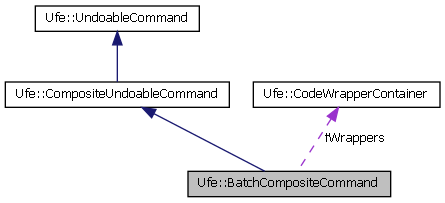

Inheritance diagram for Ufe::BatchCompositeCommand:
Collaboration diagram for Ufe::BatchCompositeCommand:
