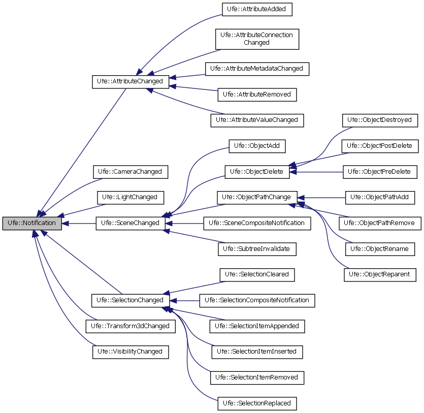

Inheritance diagram for Ufe::Notification:
