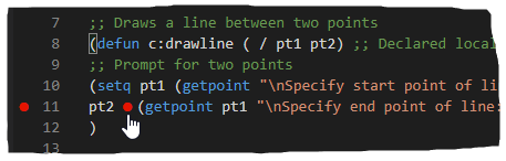

Inline Breakpoint
  1. Switch to Visual Studio Code.
  2. In the editor window, on Line 11, click to the left of the opening parenthesis.
  3. Right-click and choose Add Inline Breakpoint to add a breakpoint at the beginning of the nested AutoLISP expression.
  4. Switch to AutoCAD.
  5. At the Command prompt, enter drawline.
  6. Specify a point for the start point of the line.
    After specifying the first point, execution is interrupted by the inline breakpoint.
  7. Switch back to Visual Studio Code.
  8. On the Debug toolbar, click Continue to resume execution.
  9. Switch back to AutoCAD and specify a point for the endpoint of the line.

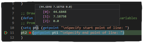

  4. Switch to Visual Studio Code.
  5. Move the cursor over the pt1 variable above or in the highlighted statement to view the current value assigned to the variable.
  6. On the Debug toolbar, click Step Into.
  7. Switch back to AutoCAD and specify the second point.
  8. Switch back to Visual Studio Code and click Step Into again on the Debug toolbar.
  9. View the value assigned to the pt2 variable.

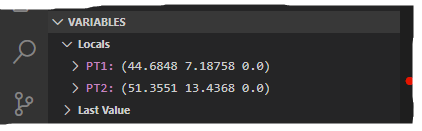

    Along with positioning the cursor over a variable to view its current assigned value in a tooltip, the values assigned to all local variables can be viewed in the Variables section on the Run view.
