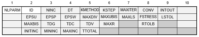

Description: Defines a set of parameters for nonlinear static analysis.
Format:
Example:
Field | Definition | Type | Default |
ID | Identification number. | Integer > 0 | Required |
NINC | Number of increments. See Remark 2. | Integer > 0 | See Remark 2 |
DT | Incremental time interval for creep analysis. See Remark 3. | Real ≥ 0 | 0.0 |
KMETHOD | Method for controlling stiffness updates, one of the following character variables: AUTO, ITER, or SEMI. See Remark 4. | Character | AUTO |
KSTEP | Number of iterations before stiffness update for the ITER method. See Remark 5. | Integer > 0 | 5 |
MAXITER | Limit on number of iterations for each load increment. See Remark 6. | Integer > 0 or AUTO | AUTO |
CONV | Convergence criteria, one of the following character variables: U, P, or W, or any combination. See Remark 7. | Character | PW |
INTOUT | Intermediate output request, one of the following character variables: YES, NO, or ALL, or the load increment interval for output. See Remark 8. | Character or Integer > 0 | NO |
EPSU | Error tolerance for displacement (U) criterion. | Real > 0.0 | See Remark 17 |
EPSP | Error tolerance for load (P) criterion. | Real > 0.0 | See Remark 17 |
EPSW | Error tolerance for work (W) criterion. | Real > 0.0 | See Remark 17 |
MAXDIV | Limit on probable divergence conditions per iteration before the solution is assumed to diverge. See Remark 9. | Integer > 0 | 3 |
MAXUBIS | Maximum number of iterations for an upward load increment adjustment. Applicable when the load increment is bisected or the adaptive load increment/convergence method is used. See Remark 16. | Integer > 0 | See Remark 16 |
MAXLS | Maximum number of line searches for each iteration. See Remark 10. | Integer ≥ 0 | 5 |
FSTRESS | Fraction of effective stress (![]() |
0.0 < Real < 1.0 | 0.2 |
LSTOL | Line search tolerance. See Remark 10. | 0.01 < Real ≤ 0.9 | 0.2 |
MAXBIS | Maximum number of bisections allowed for each load increment. See Remark 12. | Integer > 0 | 5 |
TDG | Terminate on displacement grid point identification number. See Remark 13. | Integer > 0 | |
TDC | Terminate on displacement component number. See Remark 13. | 0 ≤ Integer ≤ 6 or MAXT or MAXR | MAXT |
MAXT Resultant of translation displacement components. MAXR Resultant of rotational displacement components. | |||
TDV | Terminate on displacement value. See Remark 13. | Real | |
MAXR | Maximum ratio for the adjusted arc-length increment relative to the initial value. See Remark 14. | 1.0 ≤ Real ≤ 40.0 | 20.0 |
RTOLB | Maximum value of incremental rotation (in degrees) allowed per iteration to activate bisection. See Remark 15. | Real > 0.0 | 20.0 |
INITINC | Initial load increment. See Remarks 2 and 16. | 0.0 < Real < 1.0 | 1/NINC |
MININC | Minimum load increment. See Remarks 2 and 16. | 0.0 < Real < 1.0 | INITINC |
MAXINC | Maximum load increment. See Remarks 2 and 16. | 0.0 < Real < 1.0 | INITINC |
TTOTAL | Total time for creep analysis. See Remark 3. | Real ≥ 0 | 0.0 |
