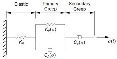

Figure 1. CREEP Parameter Idealization
Creep model parameters, as shown in the figures below, must have positive values. If the table look-up results in a negative value, the value will be reset to zero and a warning message will be issued.

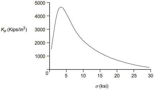

Figure 2. K p Versus σ Example for CREEP

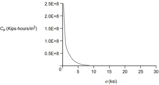

Figure 3. C p Versus σ Example for CREEP

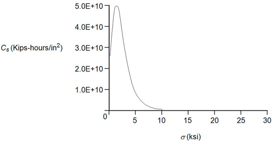

Figure 4. C s Versus σ Example for CREEP
