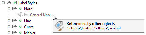

Some tick boxes cannot be cleared if other components are dependant on them. If a component is shown in grey, it is referenced by another component that is currently selected and the tick box cannot be cleared.
You can move your cursor over the component to display a tooltip that lists where the component is referenced.
In this example, the General feature settings reference the General Note style, so the tick box for General Note cannot currently be cleared.
